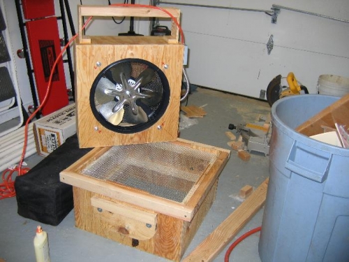

Brief Description:  Building exhaust fan for paint booth
Finished fabricating box with filters and fire screens for exhaust fan for paint booth. Building booth in garage as all attempts to find an available booth failed. Will make booth 12.5 feet long, 7 feet wide and 6.5 feet tall. Will have 20x20 inch exhaust filter (2 in a row) and 6-20x25 inch intake filters (3 will make the door). Also worked on sorting what goes to the airport and what stays here and what is thrown away. The new fuel level transducer and guage arrived.
Fan assembly
Fan assembly
