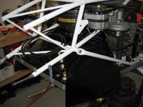

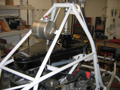

Rechecked torgues and safetying of all bolts inside chain oil bath. Finished installing chain oil bath. Put oil/STP mix in, installed rain deflector and sealed the chain oil bath. Final installed the radiator. Safeteed radiator mounting bolts and rear brace bolts. Started installing hoses (need more large fire sleeve).
Oil bath installed
Oil bath installed
Radiator installed
Radiator installed
