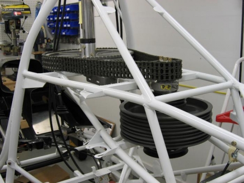

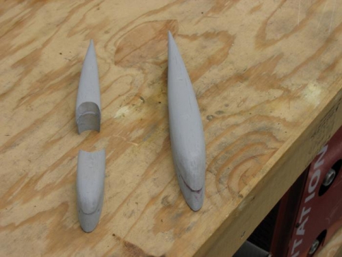

Poured lead into counterbalance. Drilled holes in counterbalance, mount, and skid. Fabricated wooden plugs for the vertical stabilizer. Initial fit of secondary drive. Needs 0.100" shim on bottom. Need to fix main rotor mast. It is 0.2 degrees off front to rear. Needs upper bearing moved forward a little.
Vertical Stabilizer plugs
First fitting
First fitting
