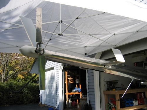

Finished empennage.
Repaired tail boom access panels. Removed and replaced Dzuz fasteners with stainless ones. Cleaned up fit on tail cone. Fiberglassed front tailcone fairing and filled with microballoons. Disassembled tail for motor installation.
