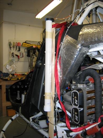

Brief Description:  Fuel Level Guage
Fabricated fuel guage calibration fixture. Attempted to calibrate transducer. Couldn't get it to register full. Level was pegged at top of range at any potentiometer position. Only registers fuel draw down when level is down to 1/2 the transducer length. Not acceptable. Will call Rotorway tomorrow.
Fuel guage calibration fixture
