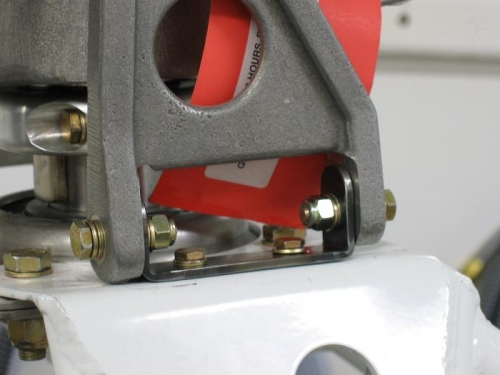

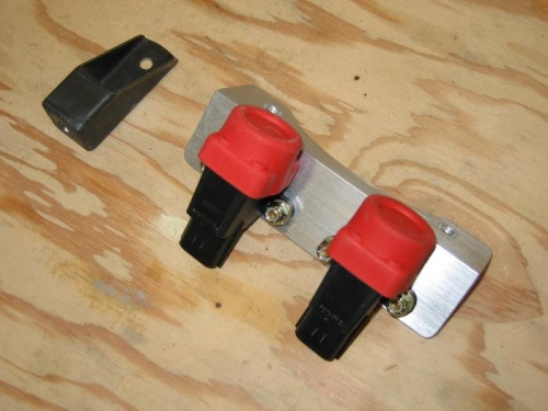

Fabricated and installed the collective scissors mount. Fabricated the inertia switch mounting plate. Drilled the rotor tach sender unit (pilot hole only for 3/4" hole). Fabricated the collective control spring bracket and trial fit the collective control rod. It will need to be attached to the collective control shaft significantly further right than in the plans to allow for clearance with the seat back. Will check with rotorway on this.
Scissor mount
Scissor mount
Inertia switch and tack mounts
