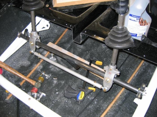

Brief Description:  Cyclic control
Fabricated cross linkage between left and right cyclic. Also trimmed bushins for best fit and nut clearance. Installed in airframe and performed initial 52 degree movement setup. Side to side is only able to attain 51 degrees and not eaqual side to side. Will contact rotorway about issue.
Cyclic installed
Cyclic installed
