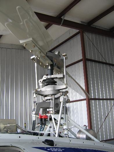

Brief Description:  Main Rotor Final Adjustments
Reinstalled the front tub section. Installed a rubber up stop for the collective and a rubber bottom bumper. It now has a minus 1.5 to plus 9.5 degrees of range. Torqued all bolts on the rotor head. Adjusted preload on c;yclic to 3 lbs at center of range.
Finished Main Rotor
