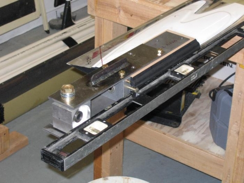

Fitting the retention straps
Sanded the main rotor blade wooden filler blocks to accept the blade retention straps. Cut notch in a level to allow for the bolt centerline measurement. Reamed the pivot hole in the blade for future gluing.
trial fit of retention straps
