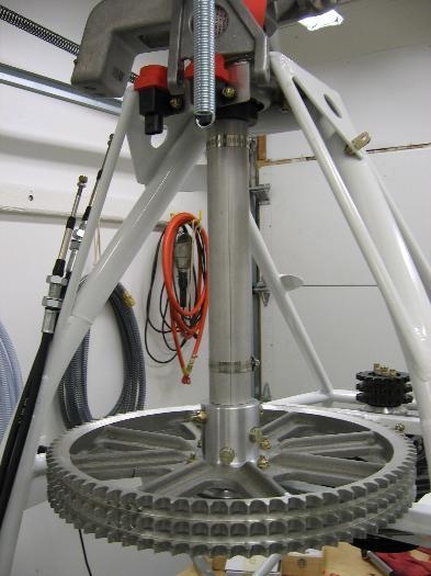

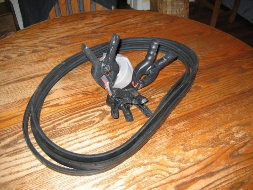

Finished shimming the secondary drive. Required .0485 and ,0375" shims top and bottom. Bottom has additional .0485. .0375 and two .009" shims. Cut the safety spacer for the main rotor shaft and cut the main drive belts. Installed the rubber striip in the upper engine mount assembly.
Safety Spacer
Safety Spacer
Drive belts and upper mount
