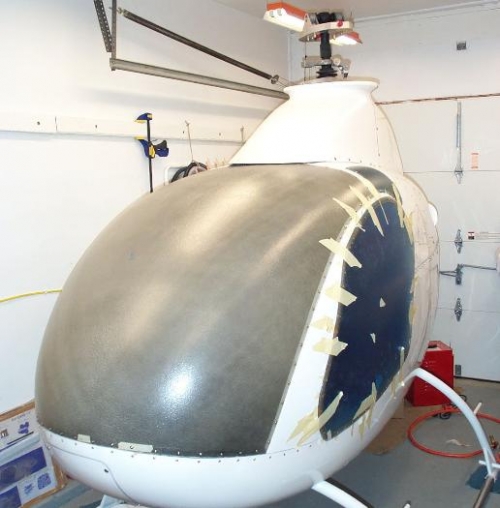

Glued up pilot's door
Removed pilot's door. Removed clecos, rough cut edge and smoothed. Debured all holes. Countersunk holes in plexiglass. Fiberglassed plexiglass to frrame. Reinstalled in opening to hold shape.
Door glued and fitted in opening
