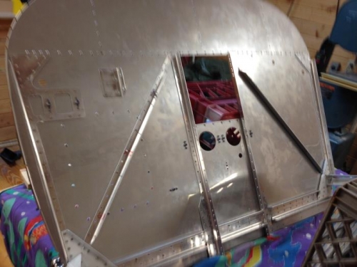

machine countersunk the angles that attach to the firewall. Noticed there are two nutplates that attach from the foreward side of the firewall. Will need to switch those installations around. Began riveting the lower channel, R and L side angles, the lower firewall brackets and other nutplates to the firewall.
Began riveting angles to firewall
