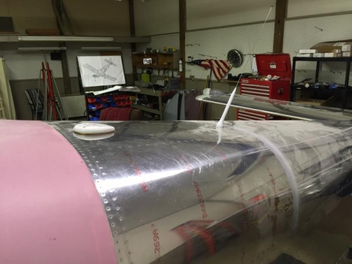

The WAAS antenna and ELT antenna install aft of the cabin on the top of the fuselage. The GPS screws into nutplates I previously installed. The ELT antenna is set in place and then a nut and lock washer secure it to the fuselage. The comm antennas install on the belly at about the steps used for entrance into the plane. They are secured with screws into nutplates.
GPS and ELT
GPS and ELT
