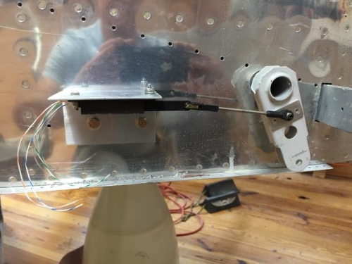

Brief Description:  Flap position indicator and magnetometer

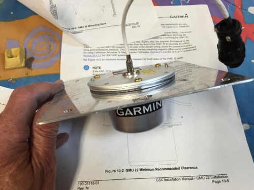

Build a support and attached the Ray Allen servo to the flap arm. I used 2" angle iron 1/16" thick for the shelf. I then placed the attach arm of the servo to the upper hole of the flap arm. Once all attached it works flawlessly. I also attached the magnetometer to its support and all to an aluminum deck. This will ultimately mount in the empennage on the support I build aft of the baggage wall.
Magnetometer
Magnetometer
