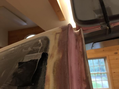

Applied more epoxy/407 fill around doors leveling out space between doors and cabin top. Sanded surfaces as well as junction of exterior to interior along rim of door. I placed a layer of flox along lower rear window at its junction with the side fuselage skin and built up this area for a smoother transition to the side fuselage. More sanding and application of fairing with 407.
Rim of door
Rim of door
