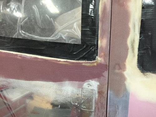

Epoxy placed around perimeter of doors to cabin to attempt leveling doors and cabin junction. This also allowed me to place a uniform 1/16 inch gap between doors and cabin so when paint is applied, the surfaces will not chaffe and remove the paint. I began cutting holes in the glareshiedl to accommodate the defrost fans.
Fairing doors to cabin top
