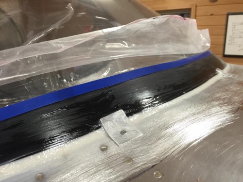

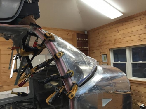

I applied Lord's adhesive to the perimeter of the fuselage where the upper and sides of the windscreen touch. Shawn Cogan helped me place the windscreen. I cleaned up the excess adhesive on the inside of the cabin. I riveted the aluminum clips onto the upper fwd fuselage that help hold the windscreen in place. I prepared flox to fill the space leftover between the lower windscreen and the upper fuselage top
Clamping window into place
Clips that help secure windscreen
