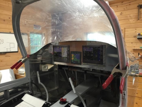

Date:  5-15-2015
Number of Hours:  6.00
Brief Description:  Windshield
I purchased all my windows from Cee Bailey. The windshield required a bit of sanding to get the fit against the fuselage satisfactory. In addition I sanded the flange of the cabin top so the window would sit tight against the cabin. I have traced out the pattern for the grey vinyl I plan to place on the glare shield once the instrument panel is in place. I am preparing to adhere and then glass in the winshield into place.
