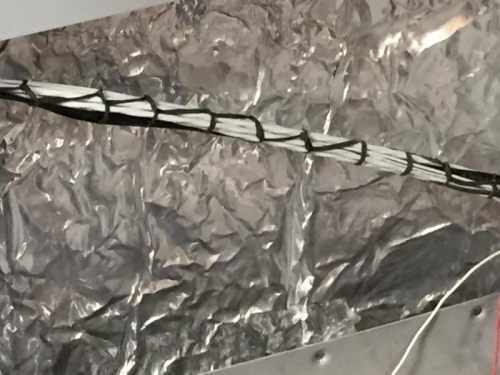

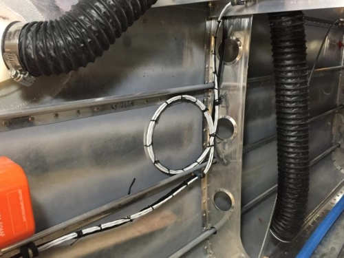

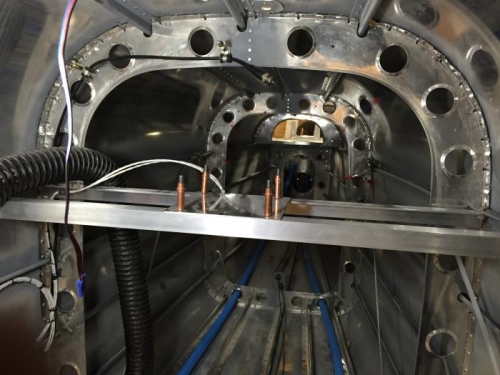

I fabricated a magnetometer shelf immediately aft of the baggage compartment. It is within two feet of the air handler where a small servo rests. Hopefully that servo will be infrequently cycled and thus minimal interferance with the magnetometer. I tied the surplus magnetometer wire along the side of the fuselage in the event I need to extend the magnetometer further aft. In addition, I nylon tied the bundle of wires that come from aft to the instrument panel on the right side of the fuselage.
Wire bundle right side tied
Magnetometer wiring tied
Magnetometer shelf
Magnetometer shelf
