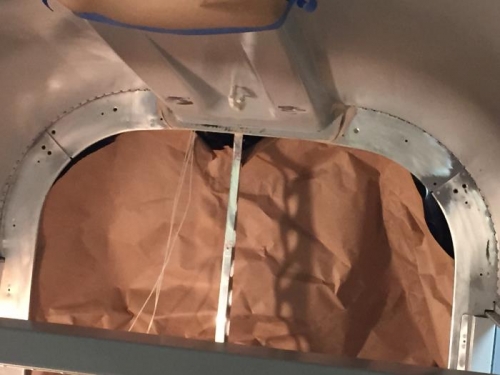

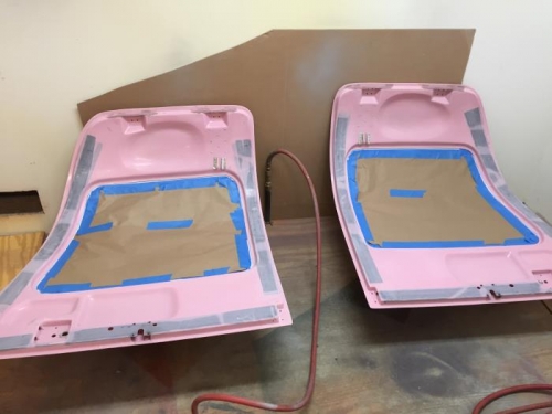

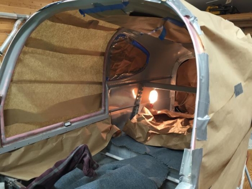

I finished epoxy around the windows in the doors and the aft cabin windows. Sanded down to 150 grit sandpaper. I Sanded the inside of the cabin around the windows and door opening. I taped off the inside around the windows and taped off the outside of the cabin at the doors to limit overspray into the shop. I epoxied the junction of the aft overhead console onto the bulkhead at the aft position of the baggage compartment. I sanded these areas and taped off the empennage to prevent over spray in that area. I finish sanded the inside of the doors and taped off the window. I removed the door locking hardware from the doors to give the best paint coating I could and limit the structures needing taping off. I used NAPA store primer and paint, the gray color matching that already used in the cabin.
