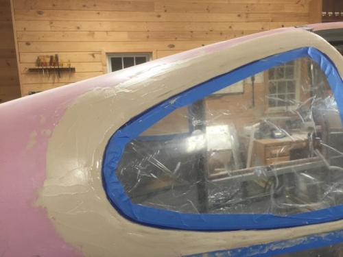

Brief Description:  Door and cabin windows
I placed two layers of crossweave and stitched cloth, each weighing 17 oz with G Flex epoxy around the windows for both the doors and the aft cabin windows. I then sanded them down and used the G flex over the cloth and 105 resin from the cloth outward. I used the orbital sander to level off. Used 410 filler to fair the surface.
Window with cloth
Window with cloth
Window with 410 for fairing
