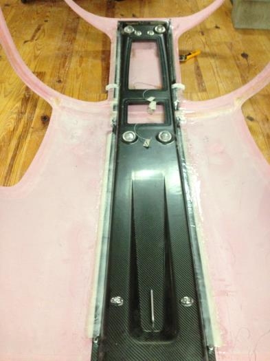

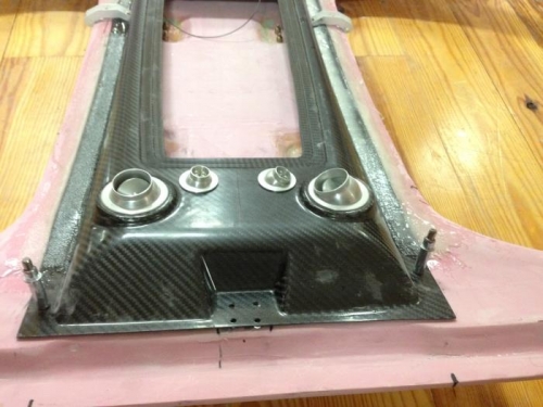

Brief Description:  Overhead console
Purchased the overhead console from Aerosports. I installed their vents and used proseal to secure them into position. Purchased red map reading lights from ACS and installed those next to the fwd air vents. They will power off a reostat on the instrument panel. Not shown, but the fwd panel is removed for installation and in that panel I have installed an Aveo Dome light that has an on/off and variable intensity within the light itself. Also installed 4 Van's LED lights; 2 over the read seat passengers and two over the baggage compartment. They will all be on the same circuit and power off a reostat on the instrument panel.Running the wires aft to the empennage and then through conduit under the baggage floor and side walls to the instrument panel.
Joggle behind pilot
Joggle behind pilot
Aerosport console
Aerosport console
Air vents and map lights
