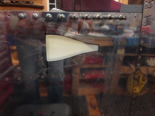

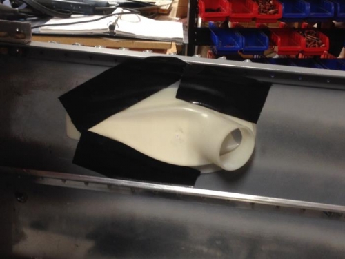

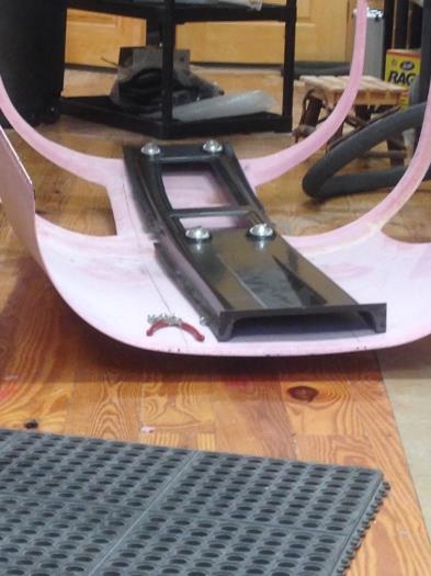

Purchased the overhead console from Aerosport. Fitted it to the inside of the cabin top. Clecoed in place for fitting. Purchased four vents from Stein air and installed them into the console. Placed the cabin top back on the fuselage. Traced the NACA vent openings on the fwd fuselage and copied the size to the side skins immediately behind the baggage door. Drilled the corners and then used a saber saw to cut out the metal. Cleaned up the openings and have the plastic NACA vents taped in place. Opened to holes in the fwd empennage bulkhead to attach to tubing attachments. I have purchased the Aerosport air flow valve which will shunt air from the outside, throught the bulkhead attachments and into the over head console. The vents on the overhead console along with the air flow valve will meter air onto the fliers.
Aerosport console
Aerosport console
Inside empennage with NACA vents
Outside skin and NACA vents
