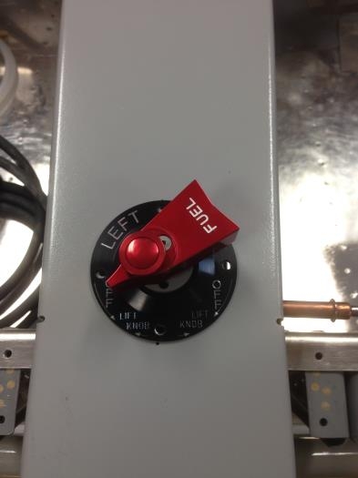

Once the valve extension was in place I needed to set the valve plate support in the correct position under the deck plate. The plate support and deck plate measure 3/32 " so needed to shorten the extension enough to accommodate this dimension. Will secure the valve plate with stainless steel screws. Not sure yet whether I will split the desk to make it easier to access the valve.
Fuel valve seated on deck over tunnel
