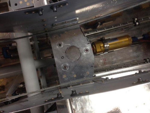

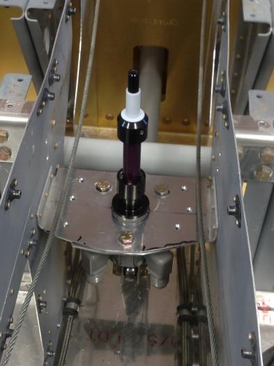

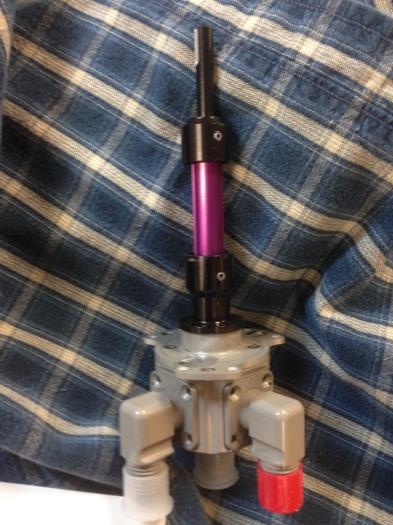

Purchased the Andair fuel valve. The shelf the valve sets upon is 4 inches below the tunnel cover. So I purchased the valve extension kit from Andair in the UK. It took 5 weeks to arrive. I modified the shelf to accommodate Andair valve instead of Van's stock valve. Then cautiously measured the valve extension length before cutting it. Then mounted the valve and extension onto the modified valve shelf.
Modification of valve shelf
Extension on valve
Extension on valve
Fuel valve in place
Fuel valve in place
