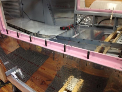

Brief Description:  Cabin attachment

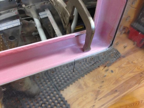

Alligned the lower cabin frame to the door frame and transferred the drill sites to the cabin. Drilled #30 holes then followed with #19 holes. Needed to assure the #2 gauge welding cable for battery power was clear of the drilling. Also images show distance of cabin from outside door frame.
Door frame drilled and clecoed to cabin sill.
