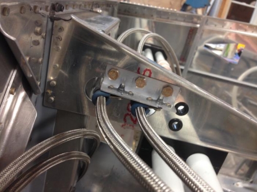

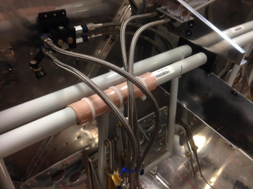

Doing some modifications to the brake lines. Needed to shorten some of the steel braided lines I received from Tom Swearengen. Also as I passed the crossover lines through the rudder pedal brace, I needed to secure them so they would not abrade against the brace. I built a support to hold adele clamps and this supports the lines from movement. Also as the lines cross over the rudder pedal attachments, I was concerned the lines would abrade against the attachments. Therefore I purchased some bondo applicators, boiled them in water so they would become pliable. I them bent them around the rudder attachments and zip tied them into place.
Bondo applicator zip tied to attachment
Fixture to stabelize lines passing through pedal brace
