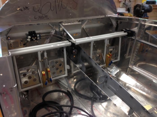

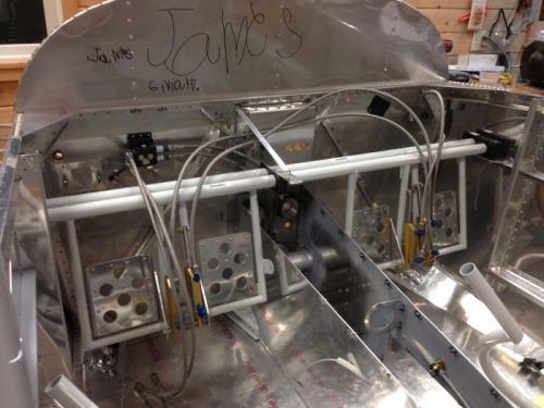

Brief Description:  Brake lines
Purchased brakes lines from Flightlines, Tom Swearingen. These are stainless steel braided lines. Ran them from the parking brake to the pilot and co pilot master cylinders. Then they run to the brake reservoir at the firewall. They allow a clean installation. The parking brake to pilot master cylinder was too long so Tom is shortening that line. Pat Howe visite today. He is a technical counselor for EAA chapter 1093 in Midland. He said all construction was looking very good including brake lines and fuel lines.
