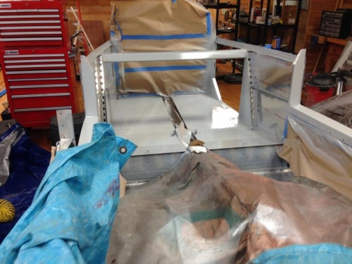

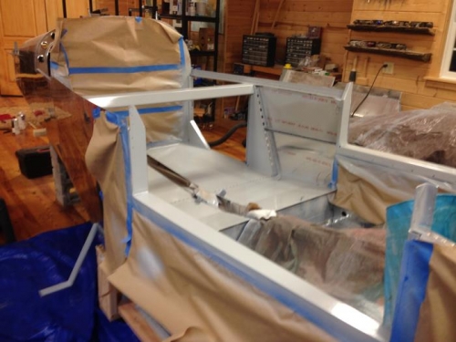

Painting the inside panels, the floors, baggage door and aft baggage wall. Used NAPA's epoxy primer and finish coat. Used a mid range gray color. Abraded the surfaces with scotch brite and cleaned them with acetone. Sprayed the surfaces with my HVLP sprayer. The surface is very solid and scratch resistent.

Taped fuselage
Taped fuselage
Taped fuselage
Taped fuselage
