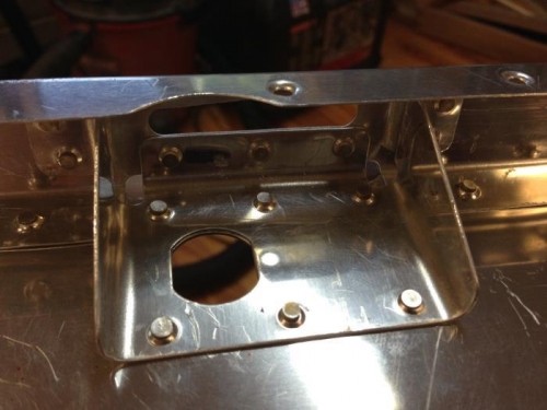

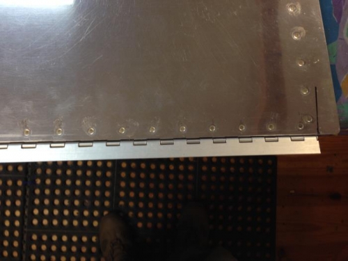

Clecoed the outer and inner baggage door panels to the framework of the door and match drilled all holes. Disassembled and cleaned all holes. All holes needed to be dimpled. Clecoed outer skin to door frame and riveted skin to frame. Will need to obtain the door latch and locks before I can finish the door. I plan to have matching locks for the baggage door, two aircraft doors and the ignition switch.

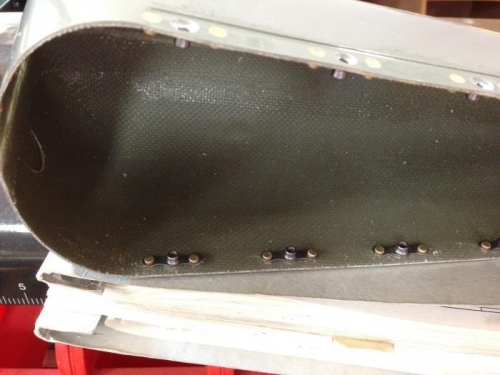

Also on the rudder bottom fairing I installed # 6 nutplates so that I can install and remove the rudder bottom fairing in the event I need to service the rear navigation/strobe light. Dick Sipp from EAA chapter 1093 visited today. He has built several RVs including a 10. He said all my rivets and construction looked good to date.
