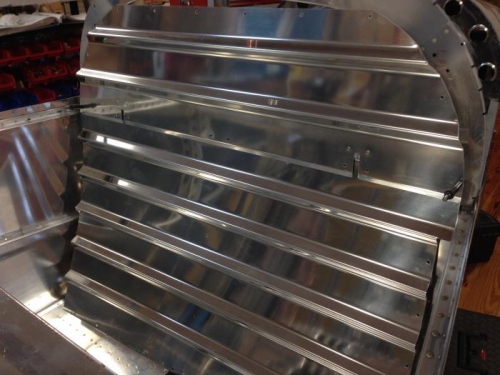

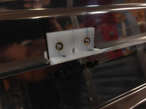

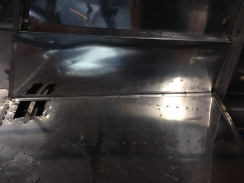

Closed in the baggage floor and the seat panels for the rear seats. Placed the baggage door seal channels in place and riveted. Riveted the baggage floor angles with the help of Shawn. The bulkhead corrugation upper and lower panels were positioned in place after the tailcone fwd top skin was positioned. The holes through the bulkhead panels were match drilled into the bulkhead. Nut plates were placed behind the bulkhead in the locations of these holes. The right baggage cover was match drilled and prepared for installation. 7/8 insulation was placed along the side wall and then the baggage cover was riveted into place. The wear blocks for the rear seat passenger seat belts were fashioned and riveted into place on the aft side of the bulkhead panels.
Wear blocks for rear seat belt cables
Right Baggage cover
Right Baggage cover
Finished bulkhead panel
