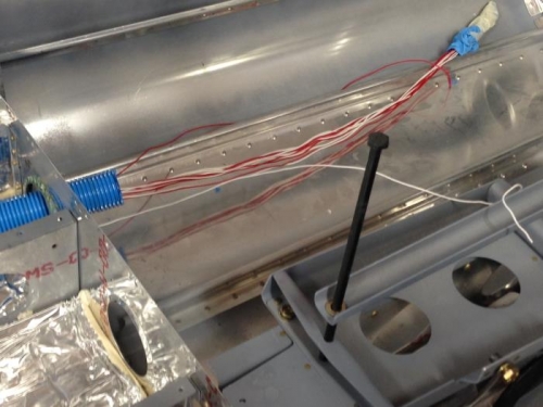

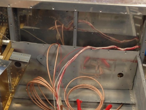

Finished access panels to the baggage floor. Then I placed insulation on the baggage floor and under the back seat passengers. Routed the battery power cords along the left side and one through the blue conduit from empennage to under instrument panel. On the right side I have routed the coax for the comm antennas and plan to route the nav antenna on the right side also. Pull wires were run through the right conduit as most of the electrical and static tubes will probably run through here.
Pulled conduit and pull wires under baggage floor to back seat
insulation, coax to com and conduit under baggage floor
Conduit from empennage to baggage floor
