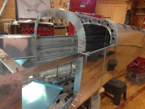

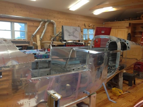

I joined then clecoed the empennage to the fuselage. After match drilling the holes I took the two sections apart. I then cleaned up the holes and dimpled the appropriate holes in the skins. I then placed proseal along the side and lower skins. The fuselage and empennage were joined again and all the rivets to hold the structures were placed. A few of the shop heads bent over and I drilled them out and replaced them.
Joined parts
Joined parts
Junction of empennage and fuselage
