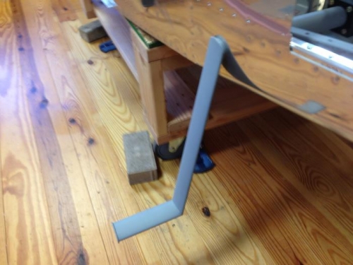

Cleaned up entry hole for step into baggage area. Prepared support block, drilled and bolted it to the mid baggage rib. Cleaned and primed the step before installing with a bolt. Needed to place step 45 1/4 inch aft of aft bulkhead. Began fabricating parts and supports for the upper fwd fuselage assembly, the support forf the avionics panel.
Step installed and primed

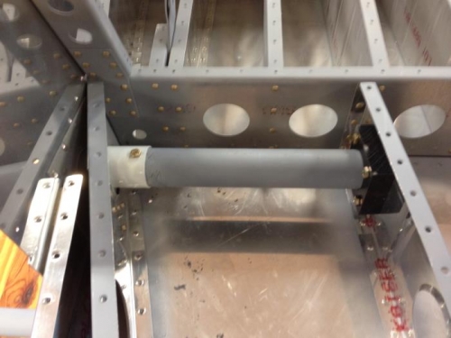

Inside attachment of step below baggage floor

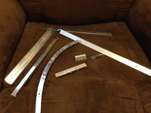

Upper fwd fuselage assembly parts
