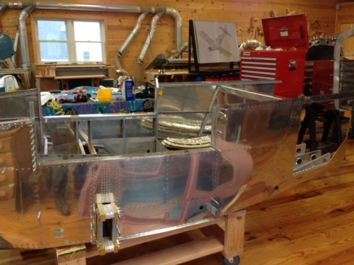

Clecoed all of the understructures to the base of the fuselage: Seat back brace, fuselage bulkheads, baggage door seal angle, upper and lower fuselage channels to firewall upper and lower brackets, fwd and mid fuselage longerons, and gussets. Then riveted all these structures to themselves of the locations they were installed at. Then clecoed the mid and fwd fuselage side skins in place, adding tank sealant to the junction at the wings of the fwd and mid skins, the lower and upper edges of the skins and the portion of the skins that wrap under the fuselage to join with the skins previously riveted on the undersurface. Then I began the laborious duty of riveting all these surfaces. I needed Shawn Cogan to help me rivet the locations I could not reach alone.
Fwd and Mid side skins riveted
