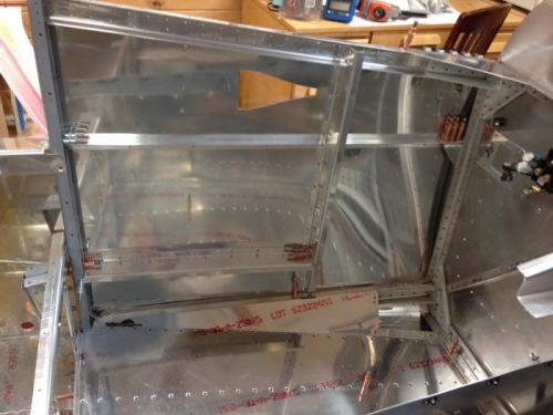

Brief Description:  Fwd side skins to frame
The fwd side skins have been clecoed onto the frame. Now it is a process of match drilling the skins to the underlying structures; Upper and Lower fuselage channels, upper and lower firewall brackets, forward fuselage ribs and fuselage bulkheads, fwd fuselage floor ribs, firewall. Gussets on longerons require drilling with angle drill from beneath. Skins drilled in center section side plates. Longerons drilled from skins to include the mid cabin decks.Now the skins will be removed and all holes cleaned up. Dimples will need to be placed.
Outside front passenger side
Inside pilot's side with cabin floor on bottom
