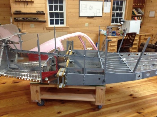

Brief Description:  landing gear mount
I spent 10 grueling hours working on the landing gear mount. The support arms needed some adjusting. I used hardware bolts and that allowed me to assure the mounts would become flush with the spar. I began fabricating the longerons, bending them with the templates and drilling #30 and #40 holes. Needed to build a rolling dolly to place the fuselage onto in order to get it off my workbench. Gave my co pilot James an opportunity to sit in the copilot space.
my copilot
my copilot
fuselage cart
fuselage cart
