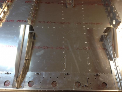

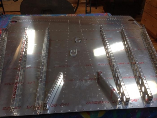

Began the process of riveting the fwd fuselage subassembly. Installed nutplates on the fwd fuselage bulkhead assemblies. Riveted the outbd and inbd fwd seat rail supports to the fwd fuselage bulkhead. Riveted the Attach angles to the Fwd fuselage ribs. Riveted all fwd floor ribs to the rwd bottom skin using the back riveting technique. Decided to use the FT-60 or Red cube for my fuel flow meter and will install this in the FWF area. Therefore riveted closed the holes in the fwd bottom skin. Riveted the fuel filter brackets to the fwd bottom skin.
Ribs riveted to fwd floor skin
