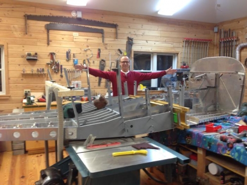

Date:  3-1-2014
Number of Hours:  7.00
Brief Description:  Fuselage construction
Joined the fwd fuselage and center fuselage subassemblies. Needed to purchase bolts, nuts and washers from the hardware store to join the spars. With the fwd and center bottom skins joined at the spars I final drilled #40 the skin holes. Then the fwd and center fuselage subassemblies were separated. I needed to machine countersink the fwd spar for the bottom skin. The mating surfaces of the fwd and center skins were dimpled. The floor ribs of the fwd bottom skin needed to be dimpled for the bottom skin and the floor of the fwd fuselage. Trying to decide whether I prepare the flo-scan mount for a flo scan or FT60. Have a question into VAF for guidance.
Fwd and Center fuselage subassemblies
