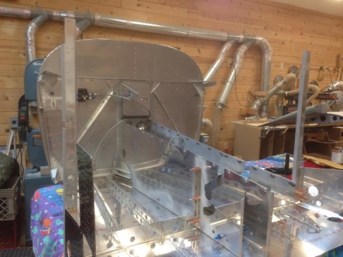

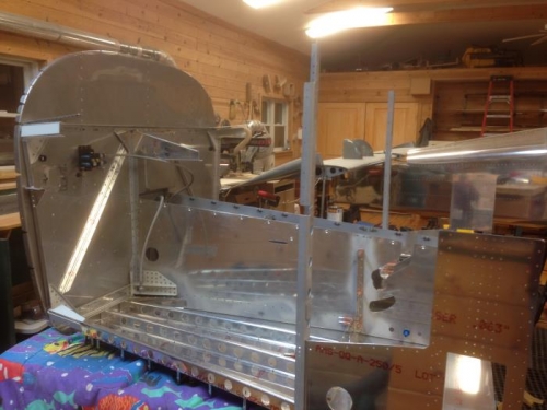

Cleaned up the edges and lightening holes of the forward fuselage floor ribs and clecoed to the lower skin. Installed the stainless steel braided brake lines I purchased from TS Flightlines. I may shorten the lenghth of them. Clecoed in place the fuel filter brackets, fwd fuselage ribs to the lower skin,t eh firewall bulkhead assembly, center section side plates, fwd fuselage bulkhead and systems brackets all to the lower skin. Match drilled the skin to all of these structures. Used lubrication when drilling into the stainless steel firewall. You can note the parking brake assembly I have installed on the aft left firewall.
Firewall with forward fueslage bulkhead
