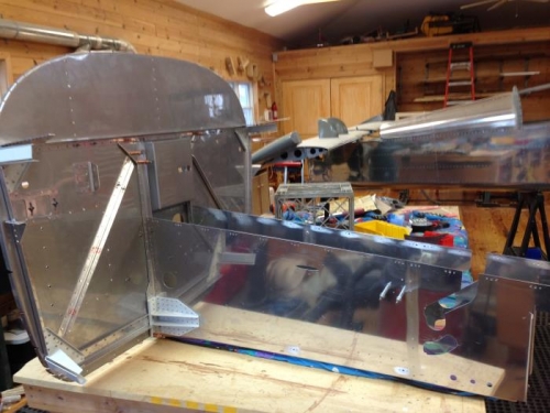

All clecoed together. Needed to disassemble the parts and prepare the mating surfaces for priming. All the rivet holes were deburred and the mating surfaces scuffed with scotchbrite. Primed with dupont self etching 7220 and final prime with dupont 7285. Clecoed back together for riveting.
Firewall preparation
