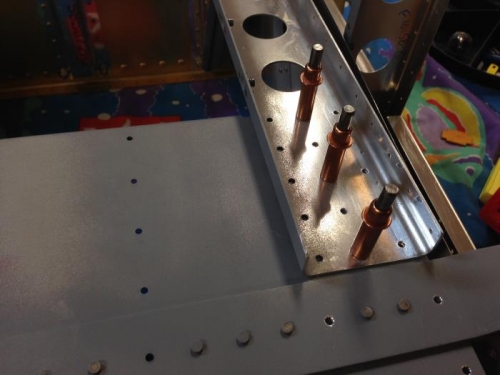

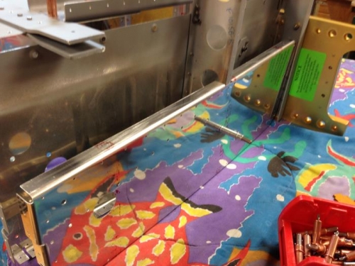

Fluted the outboard seat ribs. Clecoed the outboard seat ribs and Inboard SEat rib subassemblies to the rear spar bulkhead assembly. Match drilled holes. Dimpled the holes underneath the bulkhead side channels for rivets to the outboard seat ribs. Began working on the rear seat rib subassemblies and the remainder of the rear seat ribs.
Outboard seat ribs
Outboard seat ribs
Bulkhead side channels clecoed to the bulkhead
