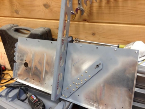

Finishing outboard seat assembly. Match drilled and deburred all surfaces. Primed mating surfaces. Clecoed and attached the Trimmed SEat Belt Attach bar, Outboard Seat Rib, and Fwd Seat Belt Anchor. Placed nutplates on Intercostal Rib and attached rib to assembly. Clecoed seat rib subassemblies to Aft center section bulkhead. Match drilled #30 holes. Dissembled, deburred and primed mating surfaces.
Outboard seat rib subassembly

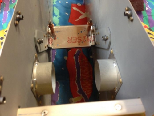

Flap actuator bracket between inboard seat rib subassemblies
