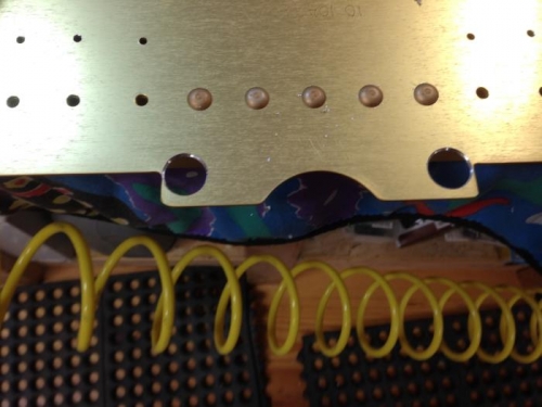

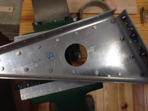

Working on FWD center section bulkhead assembly. Removed the clecoed portions, deburred the parts, cleaned and primed the mating surfaces. Riveted together the mid seat rail support subassemblies. Added the nutplates with rivets to the rail support subassemblies. Drilled out the spaces on the mid seat subassemblies and lateral bulkhead structures for the snap bushings.
Nutplates mid seat rail supports
Mid seat rail supports
