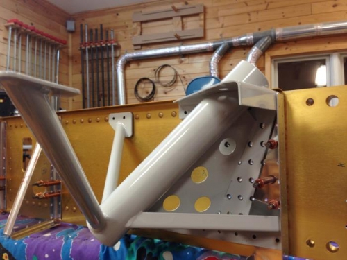

Began preparing the aft portion of the main spar today. The center seat supports and the outer spar parts and main landing gear sections. I encountered the drill bit getting stuck in the F bushing drilling the #30 pilot holes for the landing gear. Used machine oil and cleaned out the drill bit half way through the hole and this solved the problem.
Landing gear on spar
