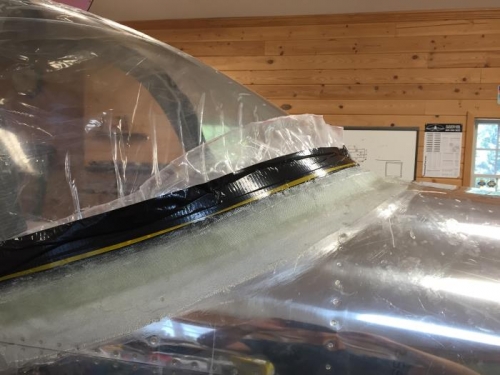

windscreen
I applied 10 layers of cloth over the lower windscreen and 2 layers of cloth over the upper windscreen to the cabin top. I applied one layer after another not letting the epoxy harden between layers.
Cloth and epoxy to base
