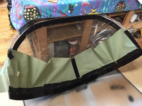

Brief Description:  Windscreen
Preparing windscreen for installation. I painted the inside base black so the fiberglas layups would not show through. I taped off the perimeter and sanded the mating surfaces with 80 grit paper. I sanded the fwd fuselage skin and etched it with phosphoric acid. I prepared the aluminum clips that will help secure the lower portion of the windscreen.
