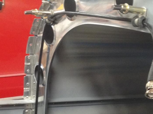

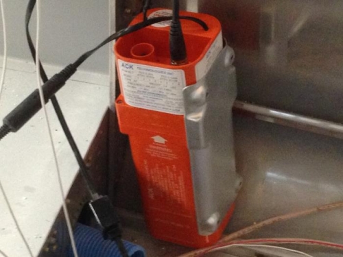

Began installation of the ELT. I will place in on the right side immediately behind the baggage compartment. You are instructed not to run the antenna cable across a riveted section of fuselage. That negates my idea of placing the antenna under that canopy in the baggage area. I routed the antenna cable to the bulkhead immediately aft of the ELT. I attached the cable to the bulkhead with Adele clamps. Routed the communication cables fwd to the panel. Awaiting a mounting plate from Van's so I can attach the ELT to the side wall.
ELT not attach yet
ELT not attach yet
ELT antenna cable
ELT antenna cable
