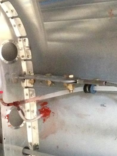

Brief Description:  Static air
Needed to crawl into the back of the empennage to install the static air lines. This is a real pain, hot, cramped. After installing the rivets in the side skins and drilling out the mandrel, I attached 1/8 " clear hose with RTV to the rivet extrussion. I then used the supplied T and attached the 1/4" clear hose. I attached this hose to the longeron with Adele clamps and routed it forward to the panel.I need to check the static line for leaks: will need to read how to do that. In addition, while back here, I installed the rear seat belt cables.
Static air installation
