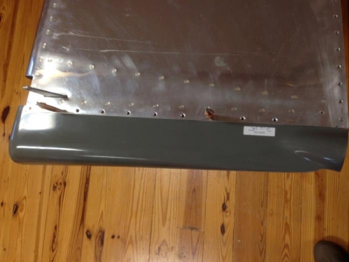

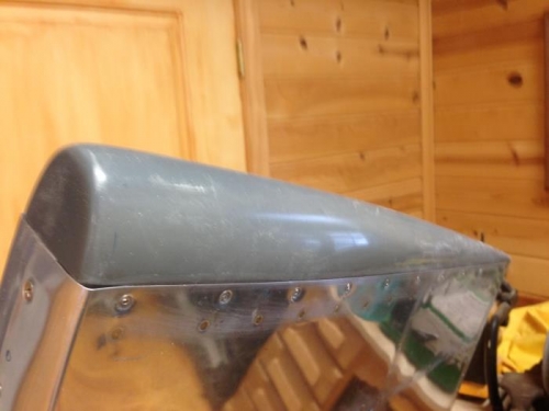

Trimmed and placed the elevator, horizontal stabelizer, and rudder fairing tips onto the structures. Needed to fit and shape the pieces to get the best fit, dimpling the associated skins, and machine countersink the fiberglas. Left the lower rudder tip clecoed only as I will add a navigation light there.
Upper elevator tip
Upper elevator tip
Lower elevator tip
Lower elevator tip
